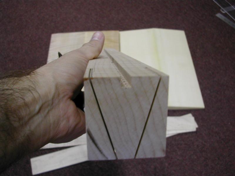

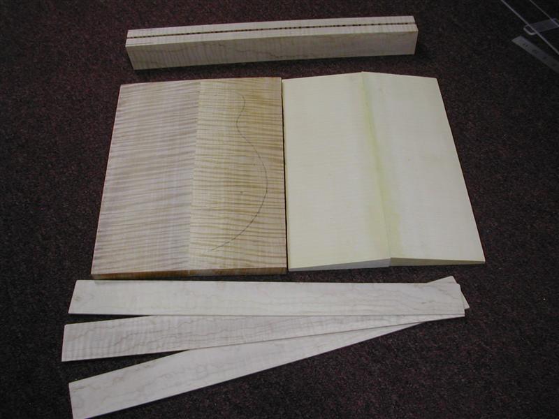

Here are pics of my progress. I did as Mario suggested and cut the truss rod slot while the neck was in block form. I also cut the 6 degree neck angle. I just need to cut the neck profile, bend the sides, and carve the top and back. As you can see from the high flame, this back is going to be lots of fun This will not be a traditional F5, as it will not have a scroll, but it will just have a cutaway where the scroll goes. I don't have pics of the form yet, but will soon.

Hey WOW Tracy, thanks for sharing these pics bud, is your truss rod channel slanted or straight? It does look straight from what i see on the last picture...
I'm asking because on Macrostie's plan, the truss rod appears to be at an angle with the fretboard! Or is it my sight that's going postal?
Very nice wood you got there, it will look awesome!
